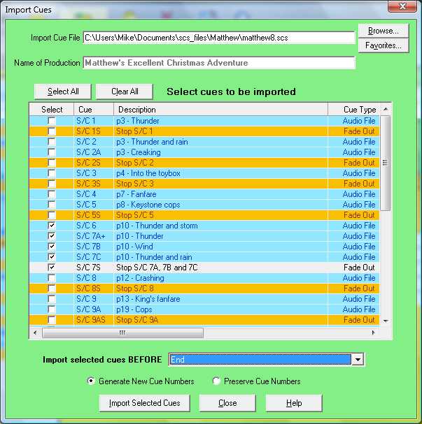

This feature enables you to copy into your current cue file selected cues from another SCS cue file (ie from another .scs file). When the Import Cues window is opened, click either the Browse button or the Favorites button to find the SCS cue file containing the cues you want to import. When you have selected a cue file a window like this will be displayed:
Import Cue File: This is the path and name of the cue file you just selected. You can select a different file by either directly changing the information in this field or by clicking the Browse or Favorites button and selecting a different file.
Name of Production: This display-only field shows the 'Name of Production' from the Production Properties of the import cue file.
Select cues to be imported: A list of the cues in the import cue file is displayed in a similar manner to the cues on the Run Screen, ie the same color scheme is used and if a cue has two or more sub-cues then a + is displayed after the cue number. It is not possible to view the sub-cues. For the cue or cues you want to import, tick the Select checkbox. You can also use the buttons above the list to Select All or to Clear All.
Import select cues BEFORE: This indicates where within your current cue file the imported cues are to be copied. If you activated Import Cues from the Production / Import Cues menu item then this defaults to the cue currently displayed in the Editor. If you activated Import Cues by right-clicking on the cue list and selecting Import Cues from the displayed menu, then the same applies but where you right-click on the cue list becomes the current cue in the Editor (just like left-clicking on the cue list). For example, if you want to import some cues before Q50 in your cue list then just right-click on Q50 and select the Import Cues menu item.
You can change the cue displayed here and select any other cue or select End if you want to import the cues at the end of your current cue list.
Generate New Cue Numbers or Preserve Cue Numbers: The cue numbers in your import file may have no relation at all to the cue numbers in your current file, and some of the cue numbers may be the same (eg you could have a Q1 in both files). By selecting Generate New Cue Numbers (which is the default setting) then when your cues are imported they will be assigned new numbers using the usual method of generating cue numbers. On the other hand, you may have set up libraries of cues for different items and have used a cue numbering convention unique for each item. For example, if you have cues for the song Memory then you may have your cues numbered MEM1, MEM2, etc. With this convention in place you may want to select Preserve Cue Numbers when you import the cues so that on being imported they retain their MEM1, MEM2, etc. numbers.
