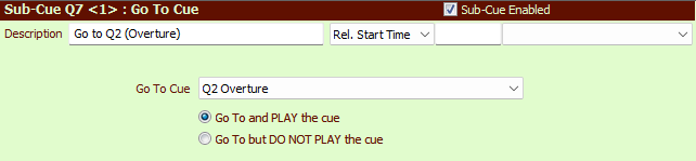

When Q6 has completed you want to loop back to Q2. To do this, set up Q7 as a GoTo cue referencing Q2. When Q7 is run, SCS will jump back to Q2 in the cue list and will immediately start Q2, unless the 'do not start' option is selected (see below).
For a Go To cue or sub-cue, a sub-cue panel like this will be displayed:
Sub-Cue Description: Enter a description for this sub-cue. You can leave this field blank and let SCS create a default Description for you.
Go To Cue
Go To Cue: Select a cue from the drop-down list.
Go To and START the cue: This is the default action of a 'Go To' cue. On repositioning the cue list at the selected cue (Q2 in the above example), that cue will be immediately started.
Go To but DO NOT START the cue: If this option is selected then the cue list will be repositioned at the selected cue (Q2 in the above example) but that cue will not be automatically started.

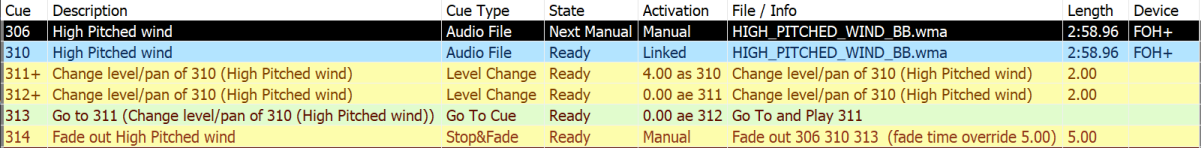

Here's an example taken from a cue file supplied by an SCS customer:
The purpose of this loop is to produce the effect of a howling wind moving around the auditorium, and this is achieved using the Level Change cues operating on the Audio File cues. Cue 313 loops back to the first of these level change cues, which keeps the audio continually moving around the auditorium. (The Level Change cues both actually contain two sub-cues, with one sub-cue changing the level of cue 306 and the other changing the level of cue 310.)
When the 'howling wind' is to be faded out and stopped, the operator will activate SFR cue 314. This SFR cue contains 'fade out and stop' entries for cues 306 and 310 (the two audio file cues) and a 'stop' entry for cue 313 (the 'go to' cue). This causes cue 313 to be marked as 'completed' which prevents it being auto-started after the end of cue 312.
