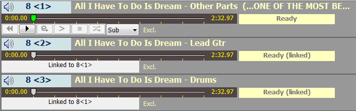

How Linked Cues and Sub-Cues Appear on the Main Screen
Where you have linked cues or sub-cues, each cue or sub-cue will displayed as for any other audio file cue or sub-cue. However, the transport controls are only displayed for the primary cue or sub-cue. For example:
The above shows three sub-cues of cue 8, ie 8<1> is the first or primary sub-cue, 8<2> is the second sub-cue and 8<3> is the third sub-cue. (There were others as well, but they have been omitted from this example.) The primary sub-cue shows the transport controls, but in place of those buttons 8<1> and 8<2> (secondary sub-cues) show Linked to 8<1>. Any transport control you click for a primary sub-cue is effectively reproduced in the corresponding secondary sub-cues. This also applies to any changes you make to the progress slider of the primary sub-cue - the same changes are made to the linked sub-cues. You will notice that the progress slider of the secondary sub-cue is disabled, ie you cannot manually move the slider.
What this all comes down to is that SCS tries to treat linked cues as a single cue.
