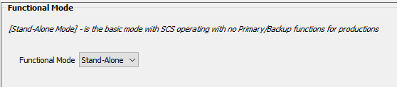

Here is the display for Stand-Alone:
No other settings are required.

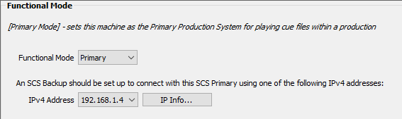

Here is the display for Primary:
IPv4 Address: The Backup computer must be configured to communicate with this SCS Primary using an IP Address that your computer and SCS recognize. The IPv4 Address drop-down list shows the IP addresses currently available on this computer.
Note: The IPv4 Address list is for information only, to assist in configuring your Backup computer. An SCS Primary listens on all available IP addresses.

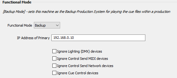

Here is the display for Backup:
IP Address of Primary: Enter the IP address or server name of the computer that is the Primary.
Ignore Lighting (DMX) devices: Only select this option if necessary, which would be the case if any DMX sent by the Backup would be sent to the same DMX network as the Primary.
Ignore Control Send MIDI devices: Only select this option if necessary, which would be the case if any MIDI sent by the Backup would be sent to the same MIDI devices as the Primary.
Ignore Control Send Network devices: Only select this option if necessary, which would be the case if any control send network messages sent by the Backup would be sent to the same network as the Primary.
