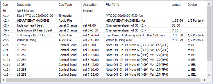

Consider the following example which contains just a single cue (cue 30) taken from a full cue file supplied by Christian Peters, but modified slightly to suit this Help topic. Here's a 'print' image for that cue:
Cue 30 actually contains 16 sub-cues, although only the first 13 are shown in the above screenshot. When the cue is started under normal circumstances, MIDI Timecode is started (sub-cue <1>) and playback of an audio file is also started (<2>). 15 seconds later, the first control send sub-cue (<7>) is played. 48 seconds after the start of the cue, a level change sub-cue (<3>) gradually increases the level of the audio file over a period of 38 seconds. And so on.

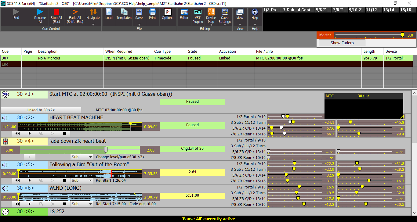

Here's a screenshot of how the cue initially shows in the main window:

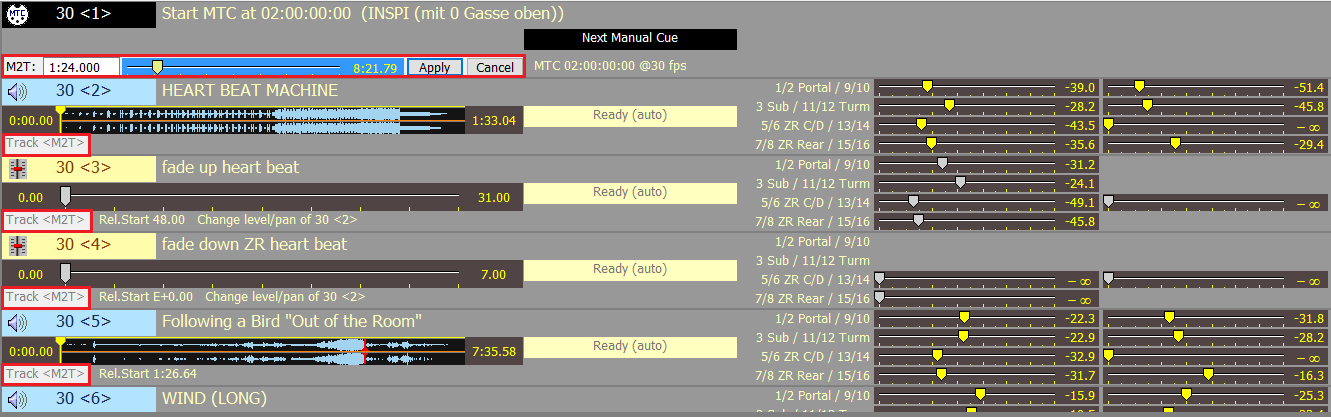

This cue (30) accompanies dancers. Suppose that during a rehearsal the director or choreographer wants the dancers to start from a position that is, say, 1 minute 24 seconds through the cue. To 'move' the cue to that position, press Ctrl+M and then enter 1:24 in the 'M2T' (Move to Time) field. This part of the screen will then look like this (note that items highlighted in red, which now replace the transport controls):
If you do not wish to proceed, click the Cancel button, or just press Ctrl+M again. If you do want to proceed, click the Apply button. SCS will now action the 'Move to Time' and the screen will appear as shown here:

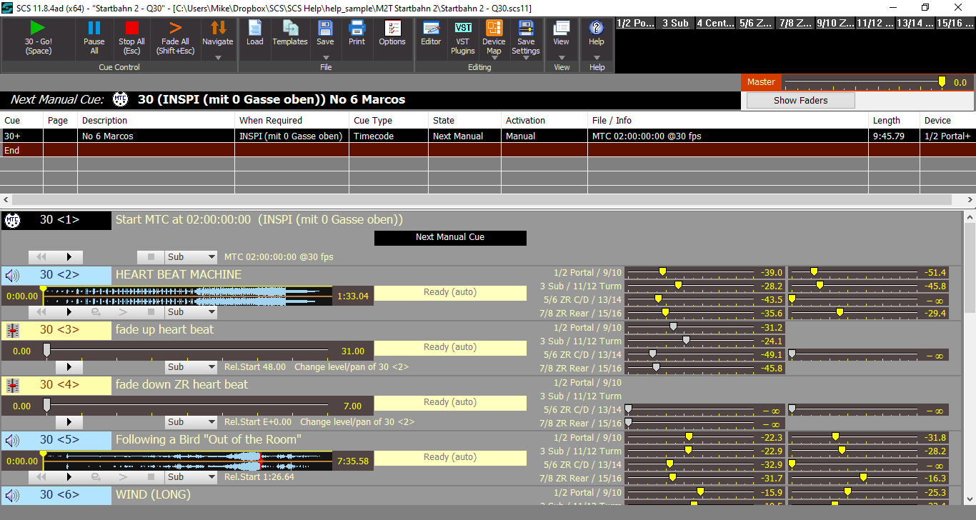

So what has happened?
MTC sub-cue <1> has been moved to the 1:24 position. No MTC has yet been sent, which is why the MTC display is blank, but when you activate 'Resume All' MTC will start from 02:01:24:00. This is calculated from the sub-cue's MTC start time (02:00:00:00) plus the 'Move to Time' value (1:24).
Audio file sub-cue <2> has been positioned at 1:24.00.
Level change sub-cue <3> is not shown as it has been completed. However, the effect of that level change has been applied to the relevant device levels in audio file sub-cue <2>.
Level change sub-cue <4> is shown as 5 seconds through. This is calculated based on the scheduled start time of this sub-cue, which was 0.00 seconds after the end of sub-cue <3>, and that sub-cue was set to start 48 seconds after the start of the cue, and had a duration of 31 seconds. 48+31+5 = 84, which equals 1:24. The effect of level change sub-cue <4> at the 5-second position has been applied to the relevant device levels in audio file sub-cue <2>.
Audio file sub-cue <5> is due to start 1:26.64 after the start of the cue, so the count-down time is now 2.64 seconds.
Audio file sub-cue <6> is due to start 7:15.00 after the start of the cue, so the count-down is now 5:51.00.
Control send sub-cues <7> and <8> are not shown as they are now marked as completed as they were set to start earlier than 1:24.00. However, they have also been processed unless this control send device has the 'do not send earlier messages' property set. Processing earlier messages is important for situations where the skipped control sends may be muting or unmuting mics. See 'When applying M2T, do NOT send earlier Control Send messages for a cue' under Control Send Devices - MIDI for more information. Please note that currently this property is only available for MIDI Out devices.
Control send sub-cue <9> and also the remaining sub-cues will have their count-down time reduced by 1:24.00.
