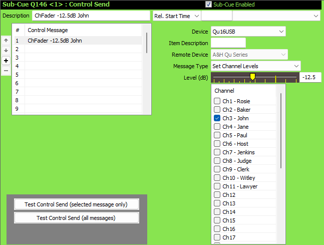

For Fader Level message types, such as 'Set Channel Levels', a Level slider will be displayed as shown below. The range of the slider is determined from data in the SCS-supplied configuration file. For example, for the Qu-16 the maximum level is +10dB. The vertical marker that is slightly higher than the others is for 0dB.
A grid will also be displayed if appropriate. For Channel Levels, select the channels to have this Level setting applied. If you need to apply different levels to different channels then you will need to use separate Control Messages.
