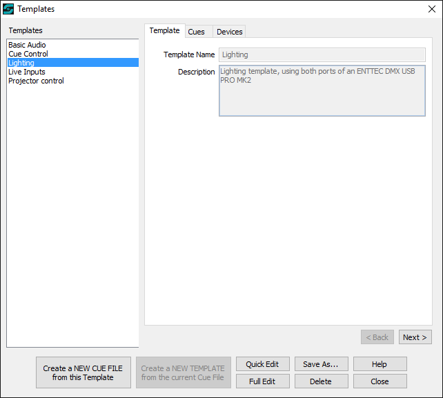

The Templates window will look something like this:
Templates: This list shows your Templates. Click on an entry in this list to see more details or to select the template for actioning one of the buttons at the foot of the window.
Panel Control (Template / Cues / Devices): The Template tab displays the Template Name and Description. These can be easily modified after clicking Quick Edit. The Cues tab displays a list of any cues included in the selected Template. Note that a template does not have to include cues - it's quite normal to have a template that just defines devices. The Devices tab contains two lists: the first list shows the included devices (eg 'Audio Output: Front') and the second list shows the included device maps.
Create a NEW CUE FILE from this Template: Click this button to create a new cue file and associated device map based on the currently-selected (highlighted) template. The Templates window will be closed and the Main Window will be displayed for this new production. Note: The 'new cue file' is initially just an internal cue file image - it is not saved to disk or other medium until you save it from the Main Window or the Editor.
Create a NEW TEMPLATE FILE from the current Cue File: This is what you will use to create a new template. You will initially shown a dialog that asks you to enter a Template Name for the new Template. (See more info below about Template Names.) Having entered a valid new Template Name the Template is then built directly from the cue file, including all the cues, devices and device maps. The Template information is displayed in the Quick Edit mode so you can easily exclude any cues, devices or device maps that you do not wish to be included in the Template, as well as entering a Description for the Template.
Quick Edit: This button enables the Template fields, so you can change the Template Name or Description, and choose to exclude selected cues, devices or device maps. Use the checkboxes to mark items for inclusion or exclusion. Initially, all items are checked for inclusion. Note that in Quick Edit you cannot add cues, devices or device maps. For that you need to use Full Edit. When Quick Edit is activated, two new buttons will be displayed: Save and Discard. Click Save to save any changes you have made or to save a new template. Click Discard to discard any changes you have made or to discard a new template.
Full Edit: Use Full Edit if you need to do editing that cannot be done using Quick Edit. Full Edit will close any currently-open cue file (you'll get a warning with an option to cancel!) and the template will be opened and may be viewed and edited just like any cue file. You can add cues, devices, etc, and you can also play cues, etc, At the foot of the Main Window a message will be displayed advising that a template is being edited, and displaying a Close Template button. The message (but not the button) is also displayed in the Editor. Some Editor functions are not available while you are using Full Edit of a template.
Save As: This enables you to make a copy of the current template, with a different Template Name. You will be prompted for the New Template Name. You can then edit your new template as required..
Delete: Use this button to delete the currently-selected Template. Note that this will not affect any cue files that were initially created using this template as cue files do not retain any links to templates.
Help: Displays this Help page.
Close: Closes the Templates window. If there are unsaved changes then you will asked if you want to save the changes.
