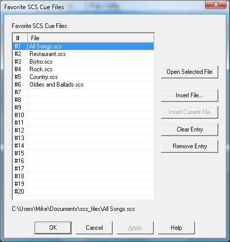

The Favorite SCS Cue Files window will look something like this:

Favorite SCS Cue Files: This list shows your Favorite Files. Click on an entry in this list to see the full path name of the file, and/or to select the file for acting on with the buttons on the right.
Open Selected File: Opens the selected (highlighted) file. Any changes you have made to the Favorite Files list will be saved, and the Favorite Files window will be closed.
Insert File: Opens the Windows file bowser window to enable you to find an SCS Cue File that you want to add to your list of Favorites. The selected file will be inserted into the list before the highlighted entry, and the remainder of the list will be pushed down to accommodate the new entry. Note that this operation only adds a file to the Favorites list - it does not open the inserted cue file.
Insert Current File: Adds your currently open SCS Cue File to your list of Favorites. The file will be inserted into the list before the highlighted entry, and the remainder of the list will be pushed down to accommodate the new entry.
Clear Entry: This button removes the highlighted file from the list but just leaves the entry blank and does not compact the remainder of the list. This means that any following files in the list will retain their current Favorite File # (number) which may be important if you are using Key Mapping to open specific files.
Remove Entry: This button removes the highlighted file from the list and moves the remainder of the list up one row.
