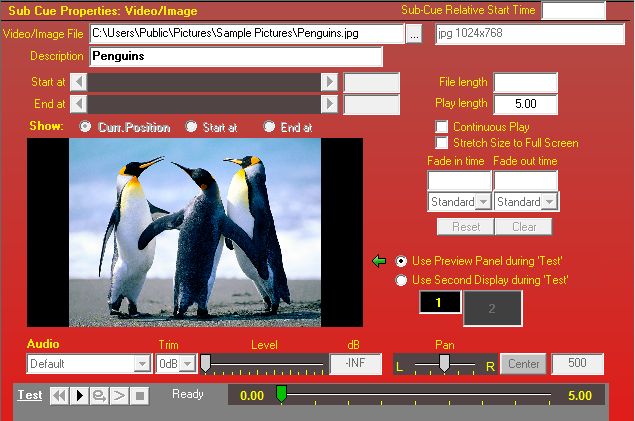

To set up a Still Image cue in the Editor, add a Video/Image Cue (or Sub-Cue) and select an image file when browsing for a file. Image file formats currently accepted are JPG, GIF and BMP. SCS uses the file extension (.jpg, etc) to determine if this is an image file rather than a video file. The Sub-Cue Properties panel will be slightly adjusted for image files, for example:
Properties are as described under Video/Image Cues except for the following differences:
Video/Image File: Still image formats currently accepted are JPG, GIF and BMP.
Description: Currently the 'description' for image files is just derived from the file name. This may be enhanced later to select the Title property for JPG files.
Start at and End at: These fields are not applicable for still images and wll be disabled.
File length: Not applicable for still images.
Play length and Continuous Play: Since still images do not have a duration, you must either enter in Play length the length of time you want the image displayed, eg enter 5 if you want the image displayed for 5 seconds, or select Continuous Play. If you select Continuous Play then the image will be displayed until the cue is stopped by an SFR cue. Otherwise the image will be displayed for the length of time you enter in the Play length field.
Whatever you enter in the Play length field becomes the default for the next still image you add. So if you want to display several images for, say, 6 seconds each image, then you only need to enter 6 for the first image and this will be the default for all subsequent images added, until you change it. Note that this only affects image cues added - not existing image cues.
Stretch Size to Full Screen: This only affects output to the secondary monitor or video projector. Videos and images are normally shown to the maximum size permitted by the screen, retaining the aspect ratio of the source image. This typically results in a black border above and below the image, or to the sides of the image. If you want your video or image to fill the entire screen, not leaving any black borders at all, then select this checkbox. This may give you a distorted image, stretched either vertically or horizontally, but in many cases this stretching may not be very noticable.
This property is implemented for still images, and for videos played using xVideo. As this property is set for each cue or sub-cue, you can choose which of your videos and images you want stretched to full screen.
Fade in time: Use this field if you want SCS to fade in the image. Leave blank if fade in is not required. For example, to fade in the image over 5 seconds enter 5 under 'Fade in time'. When you start the cue the image will fade in over the time specified (5 seconds in this example). If another image is currently being displayed, a fade in provides a 'fade transition' from the existing image to the new image. If no other image is currently displayed then the fade in provides a 'fade from black'.
Whatever you enter in the Fade in time field becomes the default for the next still image you add. So if in a slide show you want all your images to have a 1.5 second fade transition, then you only need to enter 1.5 as the Fade in time for the second image (or first image if you want that to fade in) and this will be the default for all subsequent images added, until you change it. Note that this only affects image cues added - not existing image cues.
Fade out time: Use this field is you want SCS to fade out the image. Leave blank if fade out is not required. For example, to fade out the image over 5 seconds enter 5 under 'Fade out time'. When you commence fade out of the cue the image will fade to black over the time specified (5 seconds in this example).
Type of fade: Not applicable for still images.
Audio Properties: Not applicable for still images.
