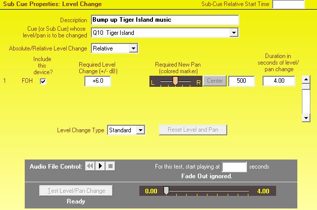

To set up a Relative Level Change cue, add a Level Change Cue (or Sub-Cue) and select Relative in the drop-down list against Absolute/Relative Level Change. The Sub-Cue Properties panel will be slightly adjusted for a Relative Level Change, for example:
Properties and Controls
Properties are as described under Level Change Cues except for the following differences:
Absolute/Relative Level Change: You must select Relative for a Relative Level Change.
Required New Level: For Relative Level Changes the fader is not displayed - only a text box in which you must enter the required dB level change. This must be entered with a leading + or - to indicate if the level is to be increased (+) or decreased (‑). See also the Note Regarding Playlists (below).
Reset Level and Pan: This button sets the Required New Level and Required New Pan settings to the 'expected' settings. As the Required New Level is a relative level, resetting will cause this to be set to +0.0 (ie neither increase nor decrease the level).
