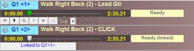

Where you have linked cues or sub-cues, each cue or sub-cue will displayed as for any other audio file cue or sub-cue. However, the transport controls are only displayed for the primary cue or sub-cue. For example:
In the display panels for Q1<1> and Q1<2>, Q1<1> (the primary sub-cue) shows the transport controls, but in place of those buttons Q1<2> (a secondary sub-cue) shows Linked to Q1<1>. Any transport control you click for a primary sub-cue is effectively reproduced in the corresponding secondary sub-cues. This also applies to any changes you make to the progress slider of the primary sub-cue - the same changes are made to the linked sub-cues. You will notice that the progress slider of the secondary sub-cue is disabled, ie you cannot manually move the slider.
What this all comes down to is that SCS tries to treat linked cues as a single cue.
