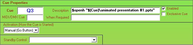

Example of a Note cue that will run an external program using the $openh command:
