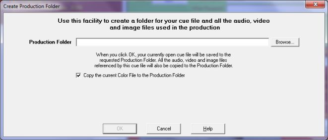

Production Folder: Click on the Browse button to either create a new folder wherever you want to, or to select an existing folder.
Copy the current Color File to the Production Folder: If this checkbox is selected then the currently loaded color file will be copied to the Production Folder when you click OK. More information is given later in this Help topic.
After creating or selecting a Production Folder, when you click the OK button, your currently open cue file will be saved to this Production Folder. All the audio, video and image files referenced by this cue file will also be copied to the Production Folder. The currently loaded color file will also be copied if the checkbox mentioned above is selected (ticked).
