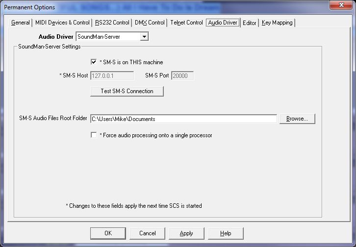

4.      In the Audio Driver drop-down list, select SoundMan-Server. The default SoundMan-Server Settings will be displayed like this:
5.      Click the Test SM-S Connection button to confirm that SCS can connect with SM-S.
6.      If the connection test is successful, click the OK button to close Permanent Options.
7.      Close and restart SCS.
8.      SCS will now be using SoundMan-Server for the playback of audio files.
