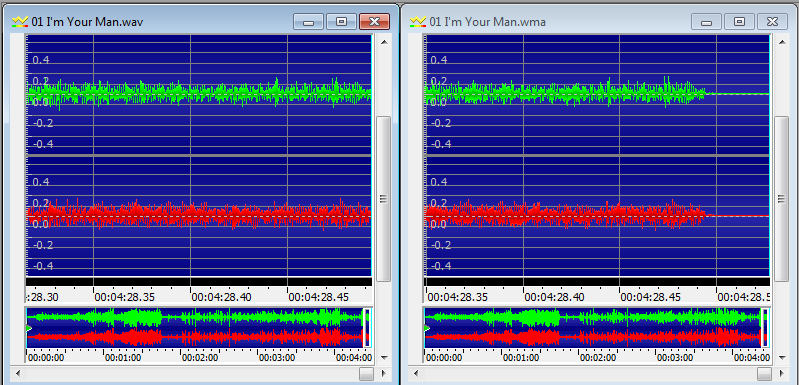

Here's a GoldWave screenshot showing the difference between a WAV file and a WMA file:
This left window shows the end of "01 I'm Your Man.wav", containing audio right up to the very end. The right window shows the end of "01 I'm Your Man.wma". The WMA file is about 33 milliseconds longer than the WAV file, and those final 33 milliseconds are silent. Both files were ripped from the CD using Windows Media Player. So if we had selected the WMA files for this example we would NOT hear gapless playback because of the 33 milliseconds of silence in the file itself.
So please use the WAV format when ripping files from CD's.
