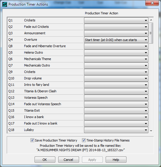

To set up the Production Timer, go to the Editor and click the Production toolbar button in the Editor and select Production Timer.
A window similar to this will be displayed:
This shows a scrollable list of your enabled cues and a drop-down list for the Production Timer Action where you indicate what action, if any, is to be applied to the Production Timer when the cue starts or ends.

Save Production Timer History: If this checkbox is selected then the Production Timer history for the current session will be saved when SCS is closed down or when the cue file (the .scs11 file) is closed. The Production Timer history will be saved in a csv (comma-separated values) file suitable for viewing in a spreadsheet program such as Excel. More details are given below.
Time-Stamp History File Names: If this checkbox is clear (and Save Production Timer History is checked) then the Production Timer history will be saved to a file named the same as the .scs11 file but with " (PT).csv" instead of ".scs11". For example, if your cue file is "MyProd.scs11" then the Production Timer history will be saved to "MyProd (PT).csv". Each time you run the production, the history file will be overwritten, which is useful if you do not want to amass a large number of history files. However, if Time-Stamp History File Names is checked then a date and time will be appended to the history file name as shown in the screen shot above. The actual date and time will be when the first Production Timer Action occurred for that run.
