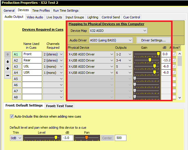

Device Maps contain settings with a darker background in Production Properties / Devices, For example:
In the above screenshot the properties within the dark background are computer-specific, and the properties within the red box are are saved in the Device Map File for this cue file (with the exception of any 'Driver Settings' you have selected). Note that the 'Active' checkbox is a run-time display-only item so is not stored anywhere.
All other production properties such as 'Name Used in Cues', 'Channel Required', 'Default level and pan when adding this device to a cue', etc are saved in the Cue File (ie the .scs11 file).
