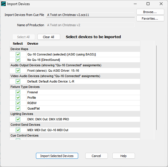

This feature enables you to copy into your current cue file selected devices and device maps from or associated with another SCS cue file. This is useful if you want to use the same or a similar device setup that you used for another production When the Import Devices window is opened, click either the Browse button or the Favorites button to find the SCS cue file containing the devices you want to import. When you have selected a cue file a window like this will be displayed:
Import Devices from Cue File: This is the name of the cue file you just selected. You can select a different file by clicking the Browse or Favorites button and selecting a different file.
Name of Production: This display-only field shows the 'Name of Production' from the Production Properties of the import devices cue file.
Select devices to be imported: A list of the device maps and devices in or associated with the import cue file is displayed as shown above. Device maps are shown first, followed by devices grouped by their purpose. By default, all device maps and devices are selected for importing. For the device maps and/or devices you do not want to import, clear the Select checkbox. You can also use the buttons above the list to Select All or to Clear All.
Import Selected Devices: When you click this button the selected device maps and/or devices will be imported. A message box will be displayed confirming the items imported or updated. When you acknowledge that message, the Import Devices window will be closed.
On returning to the Editor it is recommended that you click Apply Device Changes and then Save your changes.
Cancel: This button may be used to close the Import Devices window without performing an import.
Help: This button displays this help.
