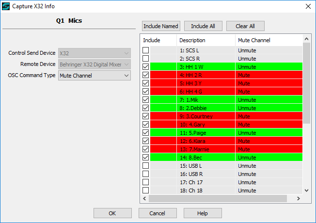

Here's an example of capturing the Mute states of the channels on a currently-connected X32 Digital Mixer, although initially all the Include checkboxes will be clear.

Cue: This is a display-only field showing the (Sub-)Cue Number and Description of the sub-cue currently being edited.
Control Send Device: A display-only field showing the Control Send Device selected in the item selected in the sub-cue currently being edited.
Remote Device: A display-only field showing the Remote Device displayed for the item selected in the sub-cue currently being edited.
OSC Command Type: This field is initially set to the OSC Command Type of the item selected in the sub-cue currently being edited, but you can change this if required. The list currently includes Mute Channel, Mute Aux Input, Mute FX Return, Mute Mix Bus, Mute Matrix Output and Mute 'Mute Group'.
Include List: This is the scrollable list shown on the right which is populated with the selected items, eg Channels, plus the current state of the relevant Mute control on the X32. The Include checkbox is used to identify the items to be included in the current Control Send sub-cue. Items that are included will be highlighted in green for unmute, or red for mute.
Include Named: This will set the Include checkboxes for all items (eg channels) that have names assigned. Using the channels shown in the above screenshot as an example, Include Named would not include channels 17 and 18, but would include channels 1-16.
Include All: This will set all Include checkboxes.
Clear All: This will clear all Include checkboxes.
OK: This will close the Capture window and update the Control Send sub-cue currently being edited, replacing any existing items in that Control Send sub-cue. This only occurs if at least one Include checkbox is selected. If no Include checkboxes are selected then then no action takes place, and the button acts the same as Cancel.
Cancel: This will close the Capture window, discarding any Include settings and leaving the Control Send sub-cue unchanged.
