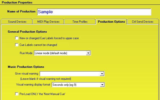

The Production Options tab looks like this:
General Production Options
New or Changed Cue Labels forced to upper case: If you want your cue labels always in upper case, then mark this checkbox. This only affects new or changed cue labels - it will not alter existing cue labels.
Cue Labels cannot be changed: If your cues have all been written up in the script then you may want to lock in the cue labels (cue numbers). By marking this checkbox, the labels of existing cues cannot be changed.
Run Mode: SCS is primarily designed to be run in Linear Mode, which means that you expect to start from the top of the cue list and progress thru the cue list until the last cue. Exceptions to this linear processing are handled by Hot Key cues, which may be fired at any time and as often as you wish. Linear and Non-Linear Run Modes are explained below.

Music Production Options

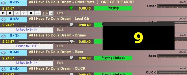

Give Visual Warning...: This property is designed primarily for users who use SCS for backing tracks, etc, in live band performances. If you select a non-blank value from the drop-down list then whenever a cue is nearing it's end you will get a visual warning of the time remaining. Various time periods are available. To determine the cue duration (so SCS knows when it is nearing the end), SCS considers the play lengths of audio file sub-cues, video/image sub-cues, and playlists. MIDI files are excluded.
You can also select 'Count UP whole cue' which will display the visual warning panel for the whole duration of a playing cue, displaying the progress time instead of the time remaining.
Visual Warning Display Format: This field enables you to set the format of the display of the 'near end' warning to either Seconds only (eg 9) or to Time format (eg 8.75, or 2.03.45). The default is Seconds only.
Example:
In live running you would probably not show the Sub-Cues for backing track cues like this.
Tip: On the visual display warning box there is a grey bar at the top of the box. You can click on this bar and drag the display to another position (although not outside the main window). SCS remembers the position across sessions.

Pre-Load ONLY the 'Next Manual Cue': This may be useful in a music production if you have many sub-cues for a music cue, and you are not needing to pre-load the following cue until the current cue has completed. By ticking this checkbox SCS will only pre-load the files for the 'Next Manual Cue', and then only pre-load them when any currently-playing cue has completed. This helps reduce the runtime memory requirement of SCS.
