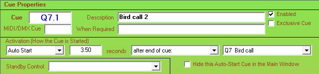

Click on a cue 'node' of the cue list tree to view and edit the Cue Properties. The upper panel to the right of the cue list tree will contain properties that are common to all cue types. For example:

Cue: Enter your required identification for the cue, eg Q3 for 'Cue 3', FX 5 for 'Effect 5', or just the number of the cue, eg 27. You can also append decimals or alpha characters to the number, eg Q3.1, FX5A, etc. This field is also referred to as Cue Number and Cue Label.

Description: This is a free-format field into which you should enter a description of the cue. You may also find it useful to include the page number in the script. For example: "p32 - Grouse shooting". The details you enter in the Description will appear in the cue list in the upper part of the main screen. Note: You can leave this field blank and have it auto-populated from the Description of the first sub-cue.
Enabled: This field indicates if the cue is currently enabled, ie the cue is to be included in the Run window. All new cues are enabled by default. Clear the checkbox to disable a cue. A disabled cue will not appear in the Run window, and will be ignored during production runs. Unlike deleting a cue, disabling a cue leaves the cue available in the Editor and so can be re-enabled later if required.

Activation (How the Cue is Started)
Activation Method (first field in this section): Normally a cue will be started by you clicking the Go! button or right-clicking the mouse. This is a manual start of the cue and is indicated by selecting Manual (Go button) as the activation method. However, other Activation Methods are also available.

Auto Start
The cue is to be automatically started a given time relative to the start or end of another cue, or to be started automatically a given time after the cue file has been loaded. You will need to enter the following fields:
Auto Start Time (before the word 'seconds'): The time in seconds, eg 3.5, relative to the start or end of another cue that this cue is to be started.
Activation Point (the next field): Select after start of cue, after end of cue, before end of cue or after cue file loaded from the drop-down list. The before end of cue option will start the current cue the specified time prior to the expected end of the controlling cue. The after cue file loaded option is used to start your cues automatically when the cue file has been loaded.
Controlling Cue (for cue-related Activation Points): Select from the drop-down list the cue that is to control the activation of the current cue. Note that you can select Previous cue which is useful if you may be moving cues around.
Hide this Auto-Start Cue in the Main Window: Select this checkbox if you don't want to see this auto-start cue displayed in the main window. If you select this checkbox for all your auto-start cues (which you can do using Bulk Edit) then in the Main Window you will only see your Manual Start cues (and any Time-Based cues).
Example: If for Q4 you select Auto Start 4 seconds after start of Q3 then Q4 will automatically start 4 seconds after Q3 is started. Note that the duration of Q3 has no bearing on when Q4 is started.
Sometimes you will want a cue to be activated immediately another cue stops or is stopped. In this case enter something like this: Auto Start 0 seconds after end of Q3.
