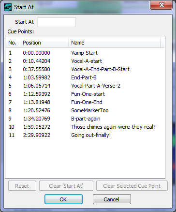

When you click a chevron button (») for Start At, Loop Start, Loop End or End At, then a window like the one shown below will be displayed. This lists cue points or markers found for the current audio file.
Cue Points and Markers

Start At: This field will be named the same as the field you came from in the Audio File Sub-Cue Properties. The field will be populated with the current field value. If you decide not to select a Cue Point (eg because a suitable Cue Point is not available) then you can enter a Start At time here, but note that manually-entered times are recorded to 1/1000 second (3 decimal places) so are not as precise as sample-accurate cue points.
Cue Points: This table shows the cue points (or markers) found for this file, listing only those with a 'name'. Any cue point or marker you want to use in SCS must have a name that is unique within the file. This usually means you need to change the default name assigned by the software that set up the cue points. If SCS finds there are duplicated cue point names then a warning message will be displayed. The warning only occurs on displaying this Cue Points and Markers window, and is only displayed once per affected file, per session.
To select a Cue Point simply click the required cue point and then click the OK button. The 'time' of that cue point will be displayed in the source field in the Audio File Sub-Cue Properties (eg in the Start At field), and internally SCS will record the cue point name and sample position.
Reset: This button just resets the Start At (or other) field at the top of the window to the value it had on entering the window.
Clear 'Start At': This button will clear the Start At (or other) field. If you then click OK then the Start At field in the Audio File Sub-Cue Properties will be cleared.
Clear Selected Cue Point: This is best explained by an example. If you have previously selected 'Vocal-A-Start' as the required cue point for Start At then Start At is effectively locked in to that cue point. The time of that cue point (as shown in the above screen shot) is 0:10.44204. By clicking Clear Selected Cue Point you can release Start At from being locked into 'Vocal-A-Start', but unlike 'Clear...' this leaves the Start At time alone, except that it is now displayed to 3 decimal places instead of 5 as it is no longer treated as sample-accurate. This means you can now make minor (or major!) adjustments to the Start At time to suit your needs in SCS, without having to move the cue point. So this action dis-associates or unlinks the Start At field from the cue point.
OK: Accepts the currently-selected setting and closes the window.
Cancel: Discards the setting and closes the window without applying any change.
