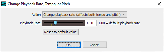

Here's an example of the pop-up screen:
Action: The required Action. The available actions are as described above, plus 'No change to playback rate, tempo or pitch', which you would select if you want to remove a previously-set action.
Playback Rate, Tempo or Pitch: This slider and the associated text box are where you set the required new Playback Rate, Tempo or Pitch. See above for accepted values. The single 'tick line' on the slider shows the default position.
Reset to default value: This resets the Playback Rate, Tempo or Pitch to the appropriate default value.
OK: This will close the window and update the Audio File sub-cue currently being edited.
Cancel: This will close the window, discarding any settings and leaving the Audio File sub-cue unchanged.
