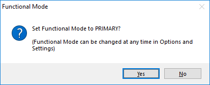

When you start SCS, if the Functional Mode last used by this instance of SCS was Primary or Backup then you will receive a message like this:
In this example, the Functional Mode last used was Primary.
If you click Yes then the displayed Functional Mode will be applied to this run. If you click No then the Functional Mode will be changed to Stand-Alone. This is particularly relevant if you've been using Backup mode on the computer and you have finished your production, and now wish to easily revert to Stand-Alone mode.
