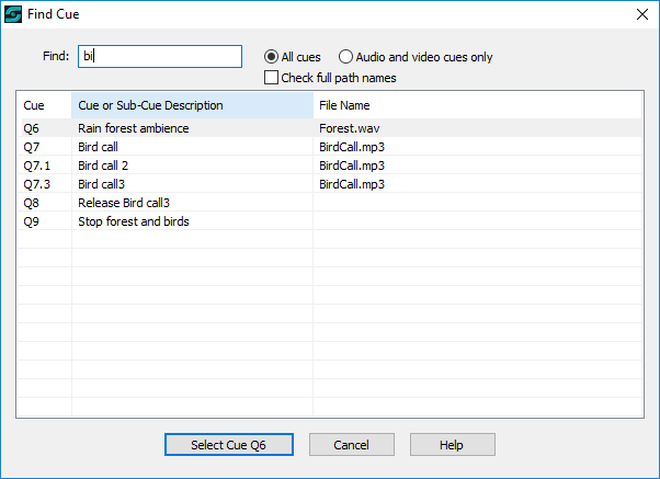

Example:
In this example, based on the supplied demo cue file, the user has enter "bi" and SCS has found six cues that contain "bi". As each character is typed in (or removed), the list is refreshed. So if the user then entered "r" making the find field "bir", Q6 would be removed from the list immediately.
