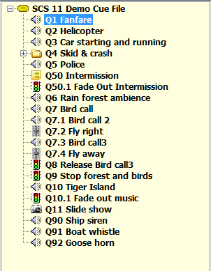

The Editor Cue List
When you drag files into the Editor Cue List (above), as you move the mouse over the cue list the cue or item under the mouse pointer will be highlighted. For example, in the above screen shot, "Q1 Fanfare" is highlighted. When you release the mouse button, SCS will create a cue or cues AFTER the currently highlighted cue or item. So in the above screen shot the cue or cues would be created after Q1 and before Q2.
SCS accepts audio, video and image files. For audio files, if you drag and drop just one audio file into the cue list then SCS will create an Audio File Cue for that file. If you drag and drop multiple audio files then SCS will display a message asking you if you want to create multiple Audio File Cues or a single Playlist Cue.
For video/image files, if you drag and drop just one video/image file into the cue list then SCS will create a Video/Image Cue for that file. If you drag and drop multiple video/image files then SCS will display a message asking you if you want to create multiple Video/Image Cues, or a single Video/Image Cue containing all the video/image files.

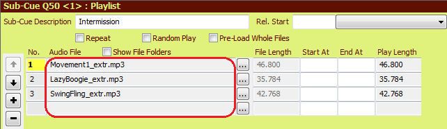

Playlist Cues
When editing a Playlist Cue you can drag audio files into the "Audio File" list to add files to the Playlist. A solid horizontal black line will indicate where the new files will be added.
