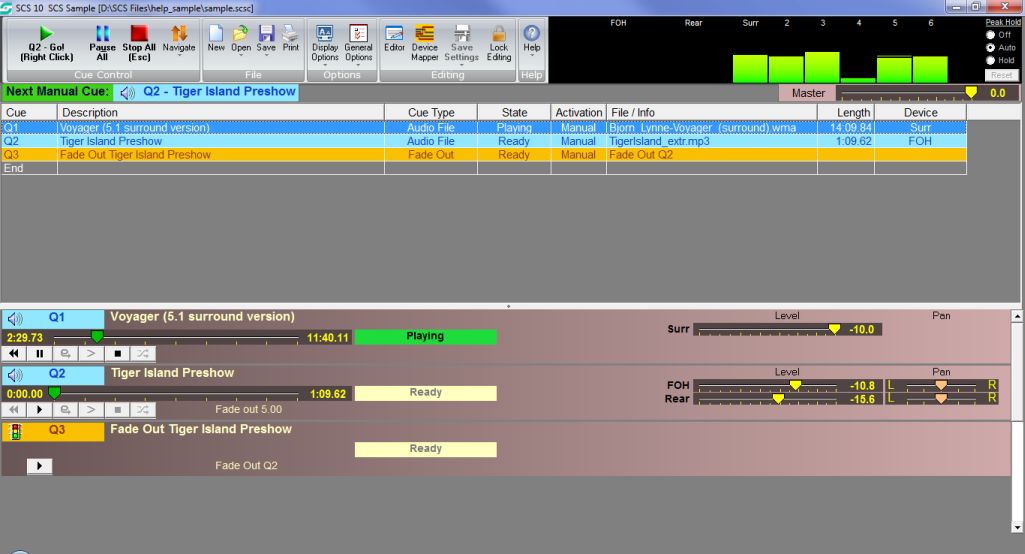

When you start SCS the last-used cue file will be opened (or the demo file if this is the first time) and the details will be displayed on the Run Screen, for example:
The Ribbon Bar at the top of the display contains your toolbar. To the right is a Meter Display, showing the levels being output to the devices defined in this production. You can also change the display to show a typical frequency analysis or a wave form, or you can suppress the meter display completely. A Master Fader is displayed below the ribbon bar. See Run Screen Ribbon Bar for details of the Ribbon Bar, or Meter Display and Master Fader for details of the Meter Display and the Master Fader.
The Cue List at the top of the display shows the cues from the cue file, and you can scroll through this list to see all the cues.
The Cue Panels below the Cue List show by default the few cues or sub-cues, starting with any currently playing cues or sub-cues. You can scroll through the cues, but note that completed cues are not displayed in the Cue Panels, so you cannot scroll to a completed cue. See Cue Panels for details.
To the right of this is the Hot Key Panel, which shows a summary of the 'hot keys', ie cues which can be activated simply by pressing a keyboard key. This panel is only displayed if you have hot keys defined for the current production.
Between the Cue List in the upper part of the screen and the Cue Panels in the lower part of the screen is a splitter bar that you can drag up or down. As you drag the splitter bar up, additional Cue Panels will be displayed, and as you drag the splitter bar down, fewer Cue Panels will be displayed. The position of the splitter bar is remembered between SCS sessions.
At the foot of the screen is a Status Line which is primarily used to display information about incoming MIDI or RS232 control messages.
