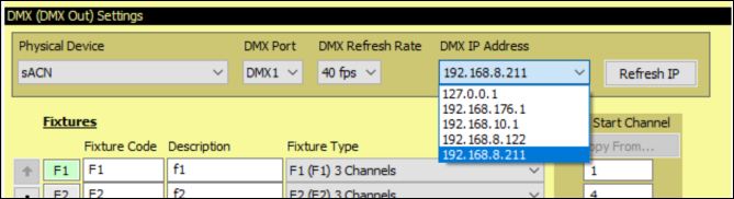

Art-Net and sACN need an IPV4 network address setting as shown in the example below which will need to match the network you are using to send DMX over.
Please note that the DMX IP Address entry has changed to a pre-filled drop down combination box of the active networks on your machine, you should choose the network that your receiving devices are attached to. If need be you can click the Refresh IP button to refresh the contents of the combination dropdown box.

Physical Device (below Settings): Select the required DMX Device from the drop-down list. The entries available in the list will depend on the installed devices and possibly whether or not they are connected and switched on. At the end of the drop-down list you will see 'Dummy DMX Port'. Selecting the Dummy entry enables you to set up Lighting cues for this DMX device even if you have no real DMX device available.
DMX Port: This field is only displayed for devices that have more than one DMX Output Port, which currently is just the ENTTEC DMX USB PRO MK2. Also, it is only displayed if you have an SCS Professional Plus or higher license. Select the required Port to be used for this Lighting Device in Lighting Cues.
DMX Refresh Rate: This field is only displayed for ENTTEC OPEN DMX USB or equivalent devices. If an OPEN DMX USB or equivalent device is used for Lighting Cues then SCS needs to constantly refresh DMX channel values sent to the device. This is not necessary with the DMX USB PRO or DMX USB PRO MK2 as these devices handle DMX refreshing internally. The DMX Refresh Rate field indicates the frequency required for the refresh. The default is 40 fps (frames per second), but you can select a lower rate, down to 25 fps. ENTTEC support have provided the following advice: "40 fps is ideal, but I would leave an option between 25 to 40 fps - just in case some fixtures don't like 40 fps."
