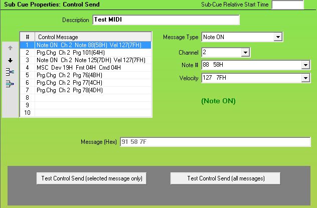

For a Control Send cue or sub-cue, the lower panel to the right of the cue list tree will contain properties specifically for control send sub-cues. For example:

Control Messages
Up to 10 Control Messages my be sent by one Control Send sub-cue, as displayed in the list on the left. The details on the right are for the currently-selected Control Message, so in the screenshot above the details on the right are for Control Message #1.
Toolbar Controls: Controls are available to enable you to easily change the order of the messages. The messages are sent in the order displayed in this list, so if you need to change that order then use the appropriate toolbar control(s). The toolbar controls available are:

Insert message
Open a new line before the current message so you can insert details of a new message. (You can also add a message just by entering the details in a blank line, such as in line 8 in the above screenshot.)

Message Type: The Message Types supported by SCS are MIDI Program Change (0-127), MIDI Program Change (1-128), MIDI Control Change, MIDI Note On, MIDI Note Off, MIDI Show Control (MSC), MIDI Free Format, RS232, and Telnet.
The two MIDI Program Change Message Types are to allow for the different standards used by different manufacturers. Some devices will expect Program numbers in the range 0-127, whereas other devices expect Program numbers in the range 1-128. If you are using the Program Change Message Type then you must select the number range that is used by the device you are sending the messages to, as the mapping of the program numbers to Hex values in the MIDI message are different. This can be seen in the drop-down list for the Program #.
The remaining fields displayed are determined from the selected Message Type.

The Message (Hex) field shows in hexadecimal the actual MIDI, RS232 or Telnet message that will be sent for the currently selected message.
