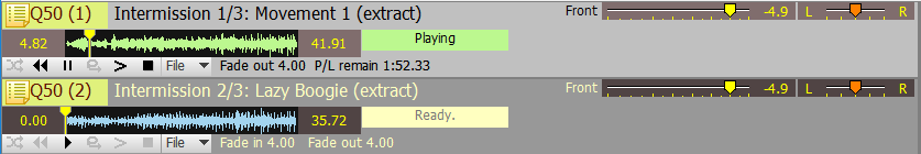

Playlist Sub-Cues
With Playlist sub-cues, cue panels are displayed for up to two tracks. These will be for the track currently playing or ready for playing, and for the next track to be played.
Transport Controls: The Shuffle button  is enabled provided the "Random Play" property has been selected for this playlist. You can only use the button prior to starting the playlist as the effect is to shuffle the play order. The button is therefore (a) only enabled on the cue panel for the first track to be played, and (b) is disabled when the sub-cue is started.
Transport Control Selector: The drop-down list showing "File" alongside the transport controls primarily enables you to stop or fade-out the whole playlist. To do this, change the drop-down list to "Cue" or "Sub-Cue" and then click the required button (probably stop or fade-out). When this selector is set to "File", which is the default for playlist tracks, then the transport controls act only on the currently playing track. Stopping or fading-out a track causes the playlist to move on to the next track to be played, if any.
The Transport Control Selector is also displayed in the cue panel for any cue that has multiple sub-cues. The default setting for sub-cue types other than playlist is "Sub-Cue", but by selecting "Cue" you can, for example, stop all the sub-cues in the current cue just by clicking the Stop transport control button.
