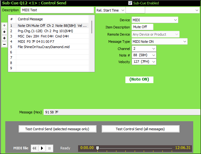

For a Control Send cue or sub-cue, the lower panel to the right of the cue list tree will contain properties specifically for control send sub-cues. For example:

Control Messages
Up to 16 Control Messages my be sent by one Control Send sub-cue, as displayed in the list on the left. The details on the right are for the currently-selected Control Message, so in the screenshot above the details on the right are for Control Message #1.
Toolbar Controls: Controls are available to enable you to easily change the order of the messages. The messages are sent in the order displayed in this list, so if you need to change that order then use the appropriate toolbar control(s). The toolbar controls available are:

Insert message |
Open a new line before the current message so you can insert details of a new message. (You can also add a message just by entering the details in a blank line, such as in line 5 in the above screenshot.) |

Device: Select the required Control Send device from the drop-down list. This list is built from the Control Send devices you have nominated in Production Properties - Control Send Devices.
Item Description: This is an optional field that you may use to briefly describe what this Control Send Item is used for. This item description is limited to 10 characters because it is displayed at the start of the Control Send item in the grid, so if too long would take up valuable space.
The remainder of screen is adjusted according to the type of that device.

Message (Hex): This display-only field shows in hexadecimal the actual MIDI, RS232 or Telnet message that will be sent for the currently selected message. (Not displayed for HTTP messages.)
Testing your Control Send Cue You can test your Control Send Cue using either of the Test Control Send buttons in the 'Test' panel. The first button tests the currently select message only, and the second button tests the whole sub-cue. Just click the required button and the message(s) will be sent if the required device(s) are available. A confirmation message is displayed in the grey panel for a few seconds. |
